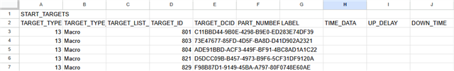

This is fwict integrated nicely for Show control for example:
I could easily build 1000 Links to 1000 Subs in 10 minutes within a .csv like this
This is not the case for macros since macro contents are not exported at all or being encoded as gibberish.
