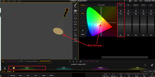

Working with some older SeaChanger XG fixtures, the fixture profile functions correctly in terms of DMX output and fixture control. However, Eos color calibration does not support CMY + Green, so in A3D the XG (extra green) filter is not quantified and/or reflected in the color output. As a result, the color picker treats the fixture as CMY only.
I'm sure there are other instances of fixtures that have an extra filter that's not apart of its standard color mixing system
