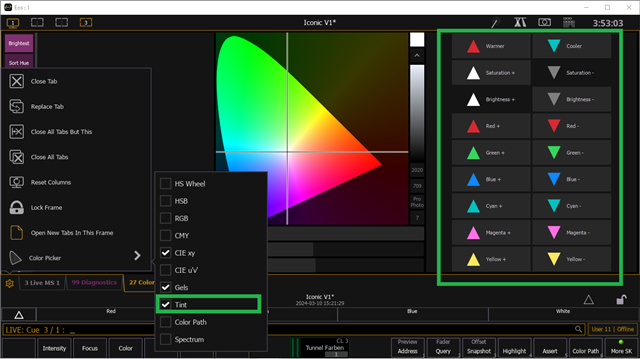

    If tonight I’m asked to modify the whole colorimetry of ShowA only for a recording that should be less blue , or just to take a look, try some colour grading, then I’d use the Tint tool right away =
    - duplicate showfile or cuelist / name it « just for this video recording »
    - select all colorpalettes / modify proportionately with Tint tool
    - check this cue, this other cue, …
    - Re-select everything and modify again OR Okay save show or update
    Not easy to compare this colour render, many colorpalettes to modify, … …

  • You know about the Tint Tool in the Colorpicker?
    Is this not to your liking?
