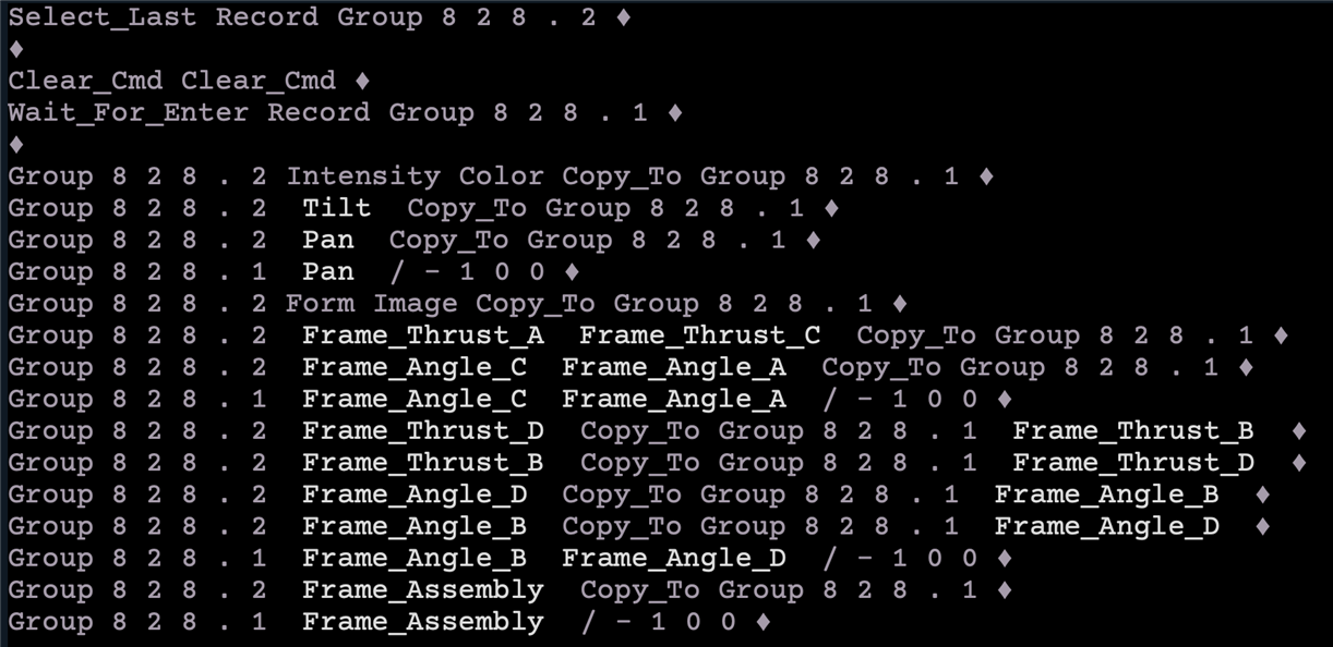

Macro
Framing Mirror
Takes one set of Chans, waits for you to put in a second set, then copies and inverts appropriate things until you have a mirrored copy. Designed for something like a FOH unit. Puts ones B shutter on the others D, but keeps A where it was, but inverts the angle. And then inverts pan and rack.
