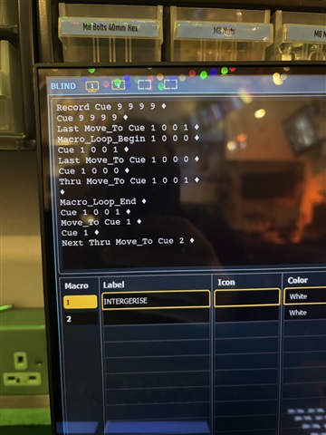

Macro
REORDER CUES TO MAKE NON-INTEGERS INTO INTEGERS
Record Cue 9999 ENTER
Cue 9999 ENTER
Last Move_To Cue 1001 ENTER
Macro_Loop_Begin 1000 ENTER
Cue 1001 ENTER
Last Move_To Cue 1000 ENTER
Cue 1000 ENTER
Thru Move_To Cue 1001 ENTER
ENTER
Macro_Loop_End ENTER
Cue 10001 ENTER
Move_To Cue 1 ENTER
Cue 1 ENTER
Next Thru Move_To Cue 2 ENTER
  • Restating the cues and pressing enter before using next, last or thru is necessary to make the macro work with multi-part cues - without it, rather than selecting the next, previous, or all future cues, it instead just selects an individual part of a multi-part cue, which breaks the macro.
