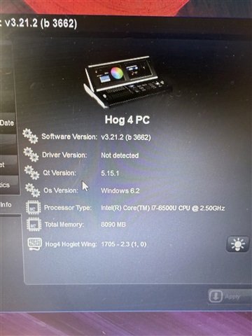

I have a laptop with Windows 10 and Hog on Pc version 3.22.1, because I was told, it doesn‘t run on version 5.
Now I have several issues:

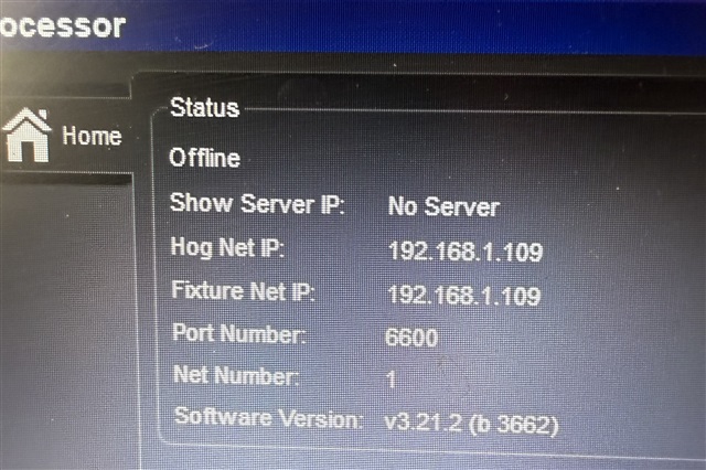

In the Start Window it says
  • Driver not detected (But I tried the re-installing guide from etc and it says it uses the newest driver for the hoglet)

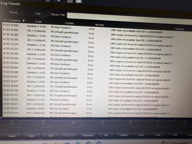

  • When I try to click on „Start Processor“ it shows No Server.
It detects the hoglet and I can use all faders and buttons.

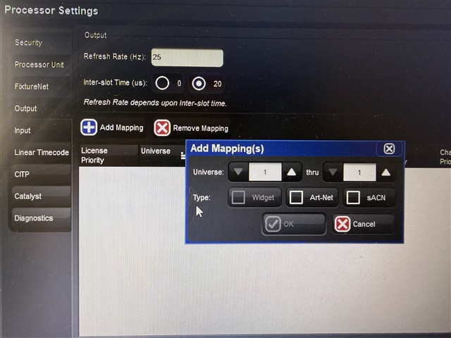

I loaded a new show and patched 4 fixtures and when I go to Setup > Network > Settings i cannot add the Widget as an output.
My firewall is deactivated, DMX is plugged in, everything has power, and I really don‘t know what I am missing.
