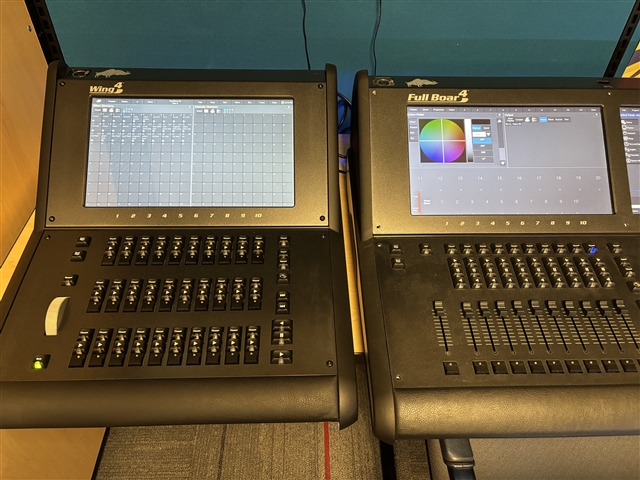

Ever since we went to hog 5.01 or 5.1 we cannot get our hog 4 playback wing to be recognized on our hog 4 full boar. we have to set it us as a customized monitor and the sizing is all wrong and not consistent to the full boar screen ratios.

Sadly, it is not. Just installed 5.2 and then spent half an hour getting it to recognise the wing as a custom screen. It does not recognise the correct resolution, so even with the grid set to large much of the screen is unused. It can be calibrated to be usuable, but it is far from ideal.
Hello, Did you set it to "Wing Rev 1" or "Wing Rev 2" depending on your model? Which DVI port are you using? I was able to get a FB4 and Rev 1 Master wing set up correctly out of DVI Port 1 on v5.2
I tried all available revisions, and only "custom" actually sent a video signal to the wing. I didn't try the other DVI port because we have a working monitor on that port, and I didn't want to risk losing connectivity to that screen. Also, our wing is on the right, which shouldn't matter, but if the DVI port matters, then so might this.
Further to my previous reply, I have since tested the wing on both DVI outputs, with the same result. Only Custom sends a signal to the wing. It is a Rev 1 wing, but "Rev 1 Wing" does not send any output to the wing (neither do the other two revisions.
