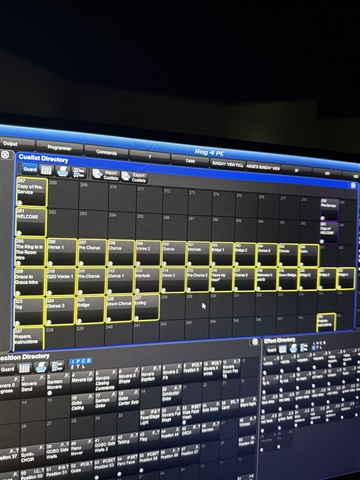

VERY novice user, but learning. Is there a way to update the setting on a fixture (or fixtures) in multiple cues at once? OR is there a way to update one cue then continue that update to subsequent cues? I've attached a picture for reference (we use cues for our operators to change for different parts of a song... in the picture, what if I want more house light in all of the "chorus" cues?) Thanks in advance...

  • you could do multiple cues in one command.
    Set the intensity as desired and type RECORD LIST 1/1 + 2/1 ....
    where the first number is the list number in the box in your photo and the number after the slash is the cue in the list. if you only have one cue per list then each will be cue 1.
    if you make an intensity pallet however you could later just update that pallet and it would update automatically in any cue where it is referenced.
