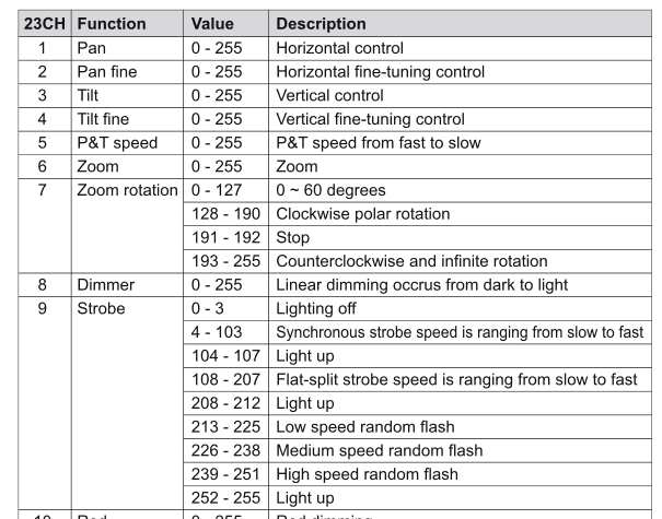

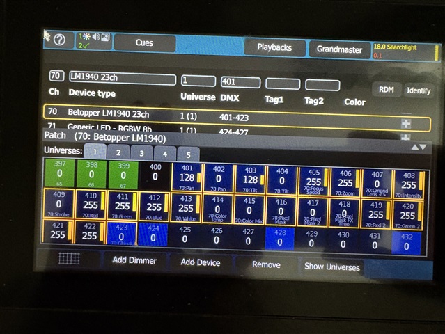

In the 23 channel mode in the library 20-0-0-2 update the strobe channel Open setting is actually closed. To get continuous light set Strobe to RND maximum. Also the XY speed channel comes up on minimum so head movement is snail pace.
If you want to use it with control of individual pixels set the fixture to 51 Ch but patch it as 23 Ch. Then patch 7 Generic RGBW fixtures immediately following DMX wise to control the individual cells. These will activate when you pull the RGB & W channels to zero using the emitter settings on the main fixture.
