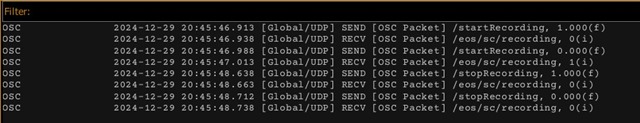

    This is the OSC output im currently getting:
    however im still not able to get show control to interact with the OSC commands.
    in sc i have the input as Input String = "recording, 1" Action = "Cue 1" but nothing is happening as i receive the OSC command back.
    This is fwict the relevant page in the manual:
    Is the comma, The space (should it be a _) or the missing "(i)" (I assume this is just a marking for integer and not relevant for the command) a problem? This is quite the learning curve :D
  • osc command has two parts: the path /this/is/the/path
    and arguments 321(i), 0.12(f)
    ignore the arguments competly in the input (its only the path without first /)
    the arguments would be passed on to the target, but im sure its not possible to use them, because it will send the recording state as a paramter, you will have to modify the obs plugin to send you another path like /recording/stopped. eos is pretty unflexible..
