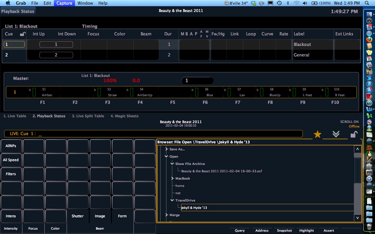

  • Okay, I have a related problem - I can see my USB show file but can't get it loaded into the Show File Archive on the OLE (Mac 10.6.8)
    In the Open menu, my Memorex TravelDrive USB appears below "net" and can be opened to show the show file.  The show file does not appear in the SFA at the top of the Open file (files that had been there from previous shows do appear and can be opened).
    In the Shell > Settings > Maintenance > Restore Show Archives, I have "restored" the file from the USB drive successfully ("1 file successfully processed") but cannot open it in the CIA.  The USB drive and the show file appear in the "Save As" file, the "Open" file, and the "Import > Lightwright" file.  I don't want to Save the running file as the new one, so I haven't tried the "Save As", but clicking on the other choices highlights but does not open or load the desired file.

  • hm, i don't think i quite understand your problem. in File > Open you can see your USB drive. and then? you click on the USB drive and there is no showfile?
  • In the subfolders of "Open", the desired file does not appear in "Show File Archives".  I does appear further down the 'Open" folder, in "TravelDrive" (my USB) but will not open.
