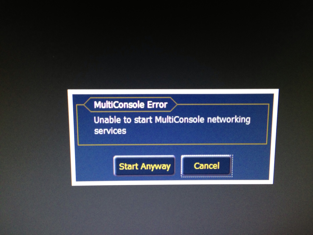

Hello all,
I have an Ion console running the latest update and every time I start the console I get a Multi-console error.  I don't have multi-console turned on in the shell.  The console is on a network with other devices.  Could it possibly be seeing the other device as a potential console?  The problem goes away if I unplug the network connection before powering on the console.  Is there a way to turn off multi-console besides in the shell?  Any insight is appreciated.
  • We'll need a little more information:
    • What version number of Eos Family software are you running?*
    • What is the complete error message?
      • An (in-focus!) photo is probably the easiest way.
    • What is the IP address of the console?

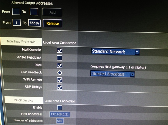

    The setting in the Shell is for choosing which network card(s) MultiConsole should use, not whether or not it runs.
    This is how the console connects to Clients (including Mirror Mode) or a Backup console. It won't try to connect to anything else.
    I would suggest enabling it for the Ion's network card because there's no reason at all to give it no network cards.

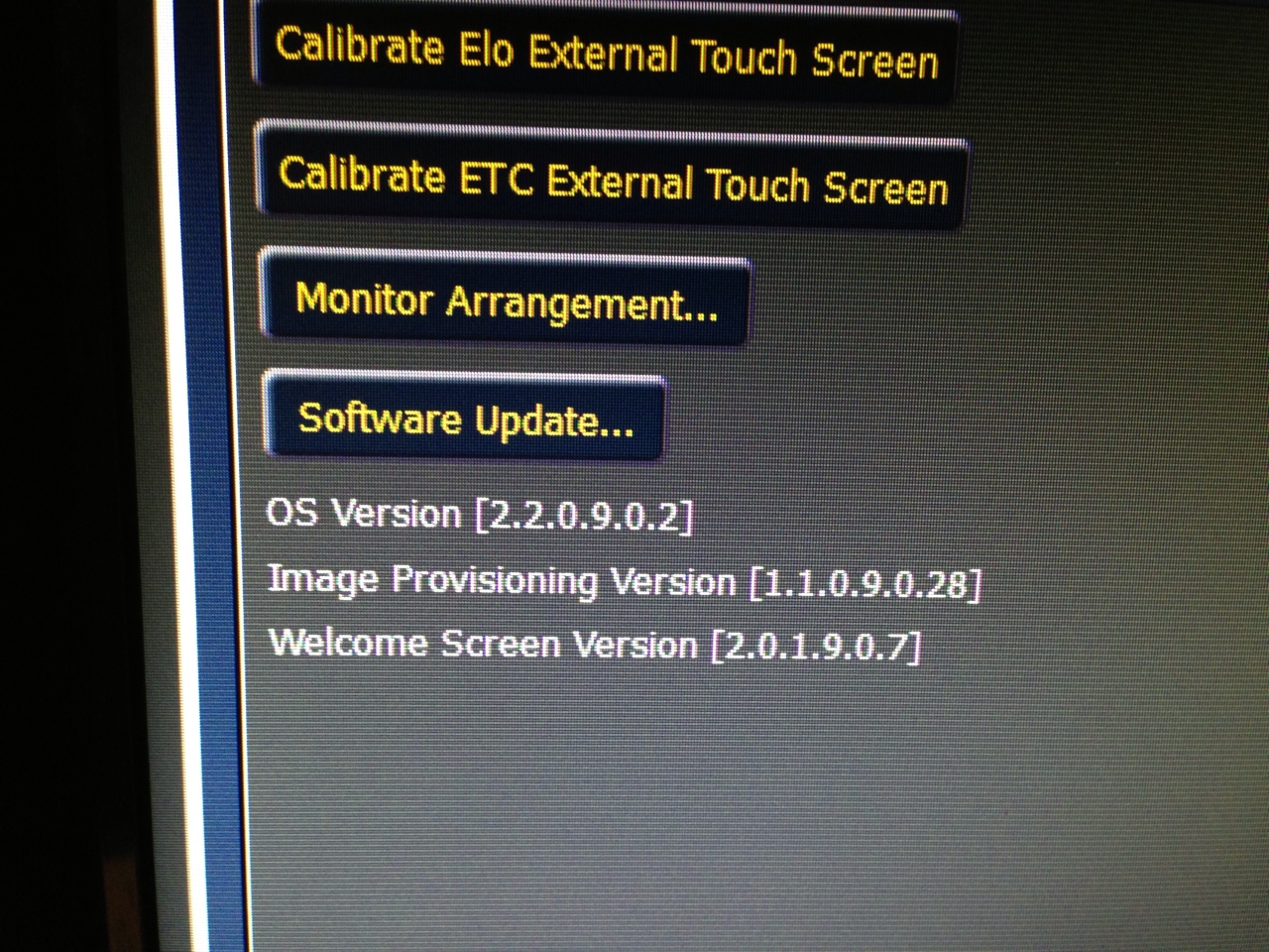

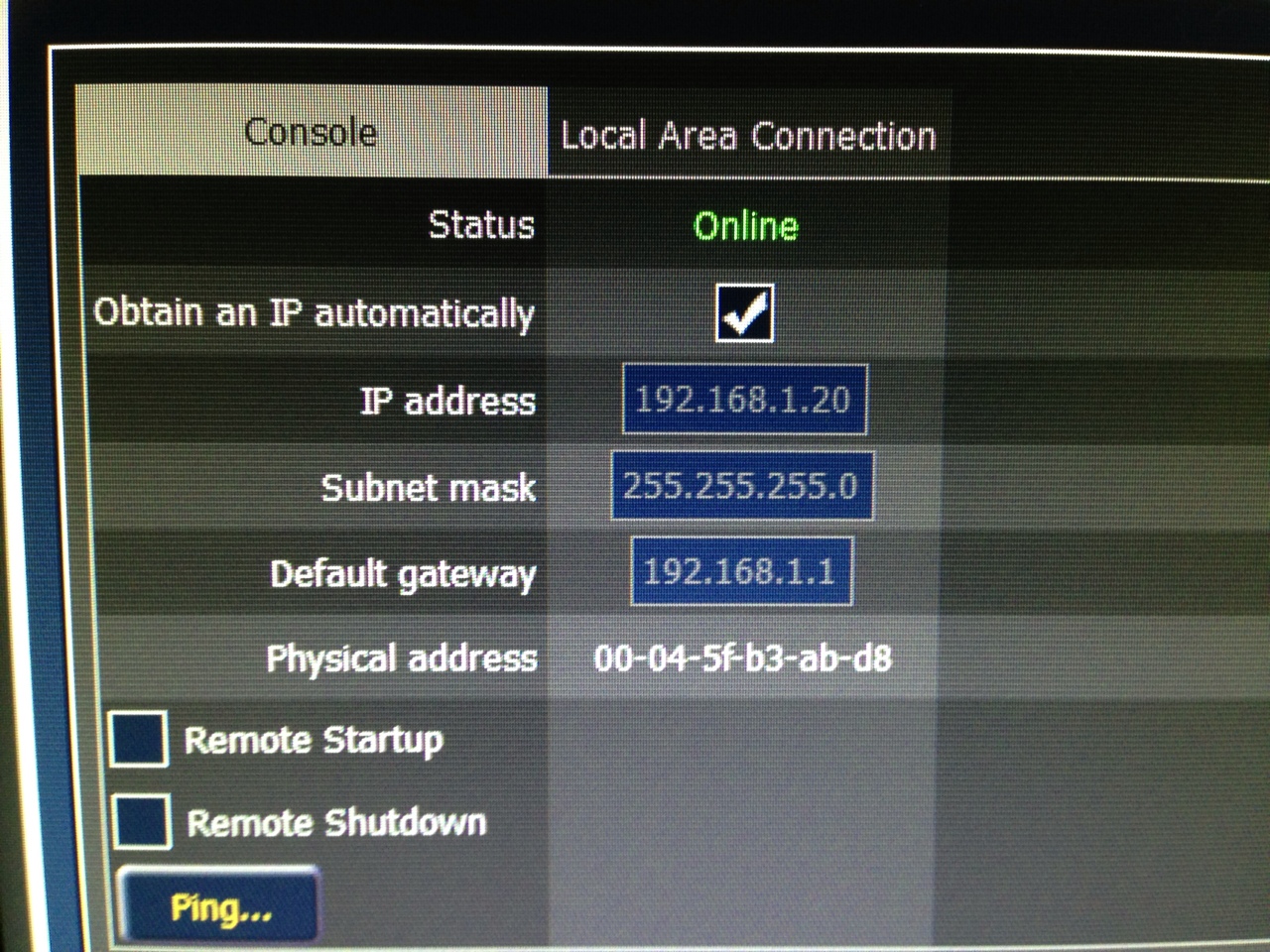

  • Attached are photos of the error, console version, and network settings.
  • Thanks for the photos.
    Is there a reason for the console being set to "Obtain an IP automatically"?
    Unless you have a specific reason that this is necessary, it should not be ticked. This is likely to be the cause of the issue.
    The vast majority of installations should use the default IP settings.
    For an Ion:
    Obtain an IP Automatically: OFF
    IP: 10.101.100.101 (to 10.101.100.253)
    Subnet: 255.255.0.0
    GW: 10.101.1.1
    Unless you have a reason not to, please try the default settings.

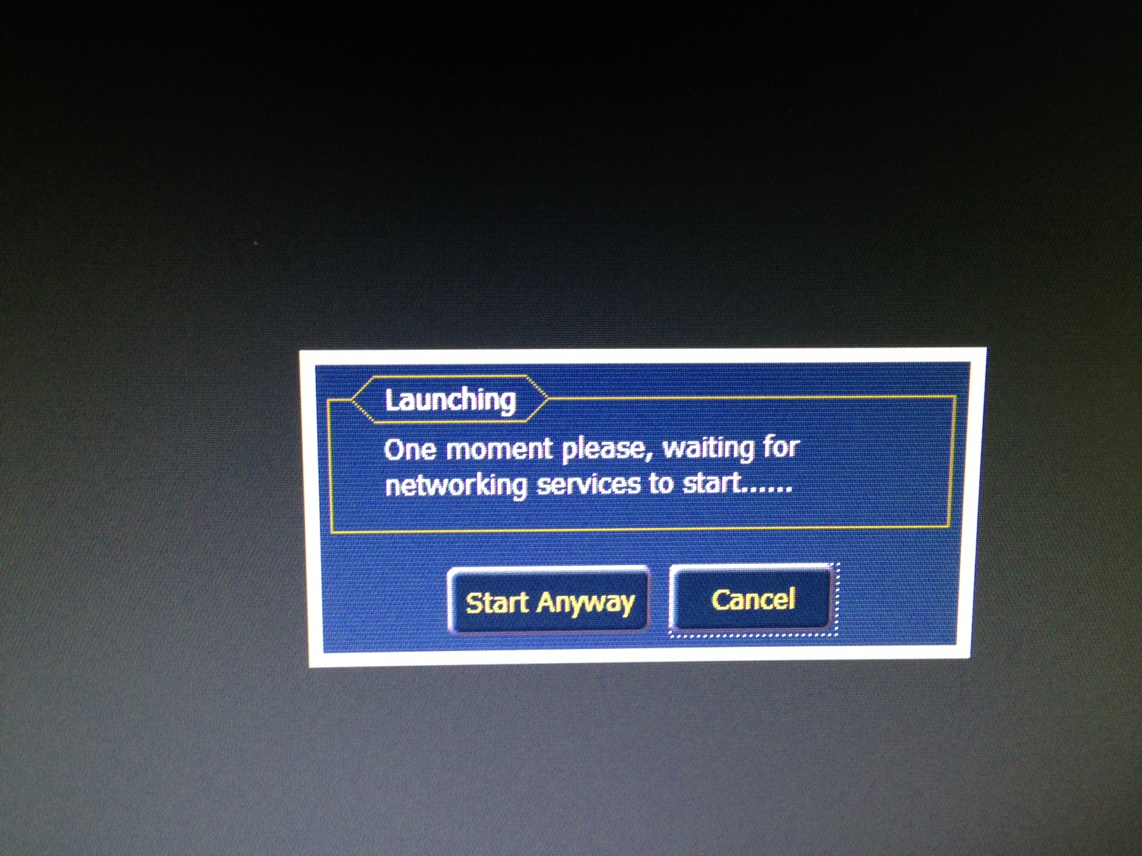

  • Also if you wait about minute, does that warning go away and the console start?
    What's happening is that the application is starting before several services that the application uses have been started.  This warning is saying that not all services are ready and you are trying to run the application without those services.  If you press {Start Anyway} the application will start mostly likely in Offline mode.
    I recommend pressing {Cancel} and then select {Primary} to start the console and the application should start up.
  • As a test, I unchecked "Obtain an IP address automatically" but left the IP address the same.  I rebooted the console and when it came back up it had a different message.  After a few seconds it went away and finished loading the application.
