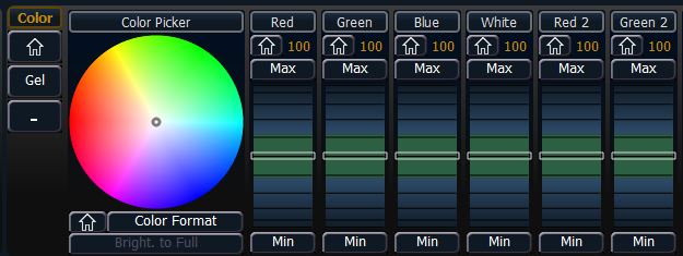

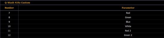

  • Hey just found out that EOS supports (from my understanding)  multiple color zones.
    Just create a costume fixtures and add the color zones. its working offline. I'll test it tomorrow and let you guys know.
    As long as the individual colors are assigned to the correct DMX values in the fixture this should work. In theory
    EX: the Chauvet Q-Wash 419 has 3 sets of 16BIT RGBW zones arranged in rings on the fixture.
    When setting up the colors you just set the colors like this:
    Red
    Green
    Blue
    White
    Red 1
    Green 1
    Blue 1
    White 1
    In the fixture profile looks like this:
    This is what it looks like in the ML Controls
