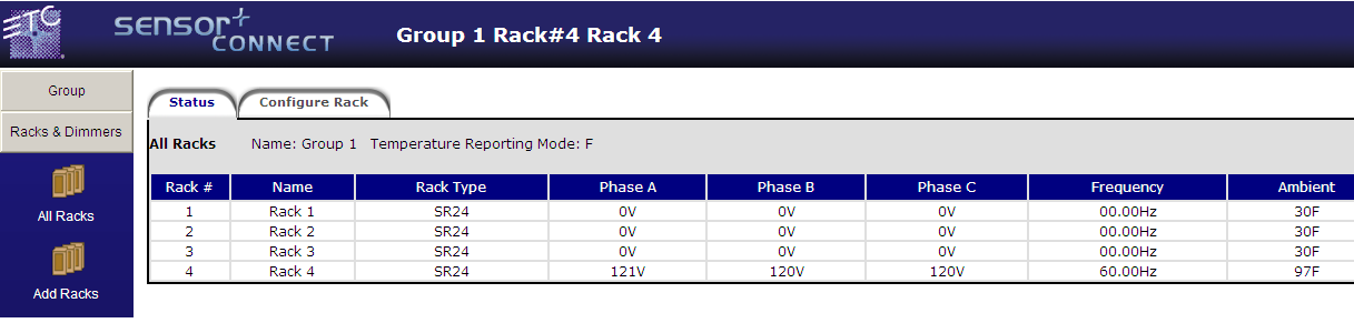

First of all, I would like to start by saying I work for a Systems Integrator and that (for several reasons) an ION console we purchase some time ago it's being installed this week. We purchase not only the console but the CEM+ module and D20´s dimmers also.
Now that we are trying to check if we connected everything properly, we haven´t found a way to make sure the ION console is actually connected and communicating with the dimmer modules.
Attached you will find a quite simple diagram of what we have installed.
If anybody could please give some pointers or tips would be great.
Thanks in advance

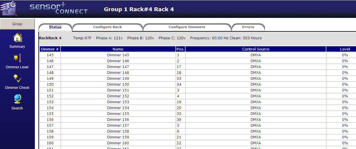

    Here's the other one. Please see that in "Control Source" column, every dimmer module advises as "DMXA" so they should be OK, am I right?
    Assuming the patch on the Sensor is the same as the Dimmer # (check the patch page of Sensor Connect)
    Then set the ION to 1to1 patch, set channel 145 to full, you should see that the dimmer on Lug 1 (Dimmer 145) is at 100%
    Additionally, if connected via ethernet the pressing [about] then {About System} you should see all the NET3 devices on the network (inc. your 4 sensor racks).
    You should be careful running both NET3 and DMX to the same rack. The rack can be configured to react to both sources. This can cause "funky" fades.
    I would recommend using only NET3 directly from the ION and leaving the DMX input for other non NET3/ACN consoles.
