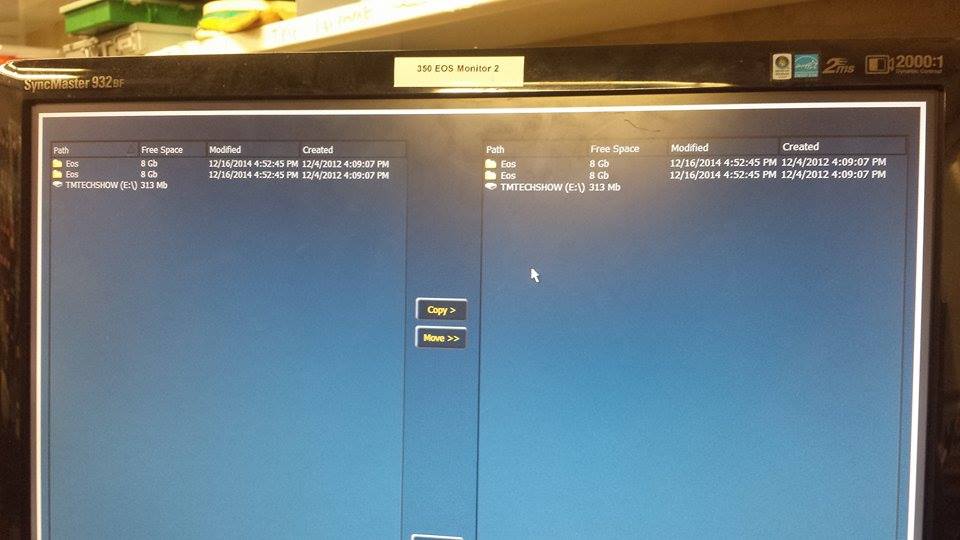

I updated our Ion today to V2.2.1 and when I went into the file manager to see what sort of mess the show files were in, I noticed that there were just two identical folders, both labeled 'EOS' and the 'Show Archive' folder is nowhere to be seen.
Attached is a picture of the file manager showing the two identical folders and nothing else! Inside the folders are all of the usual files and folders for the desk.
Any ideas where I can find the showfile archive folder and which, if any of the two folders below I can look at getting rid of? Can't delete either of them in file manager.

  • Your "Show Archive Path" may have been changed.
    This is In the Shell, Settings, "General" section.
    Click the "Restore Default" button for both Show Archive Path and Media Archive Path to put them back to where they should be.

  • Thanks Richard, it was definitely console software that was used to upgrade as I upgraded 3 desks at the same time with the same file! Thank you for the fix, a quick click to restore the show archive path put it back in plain sight.
