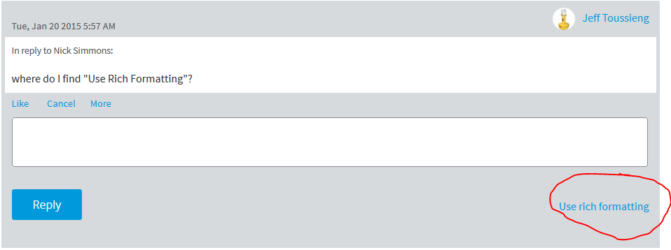

    As for the forum post, if you select 'Use Rich Formatting', you can then add attachments.

    If you could go back and edit the posts and use rich formatting that would be great.
  • Yup found it. This has been one of the best stupid help things so far in the forum. I kept looking at the Reply box.
