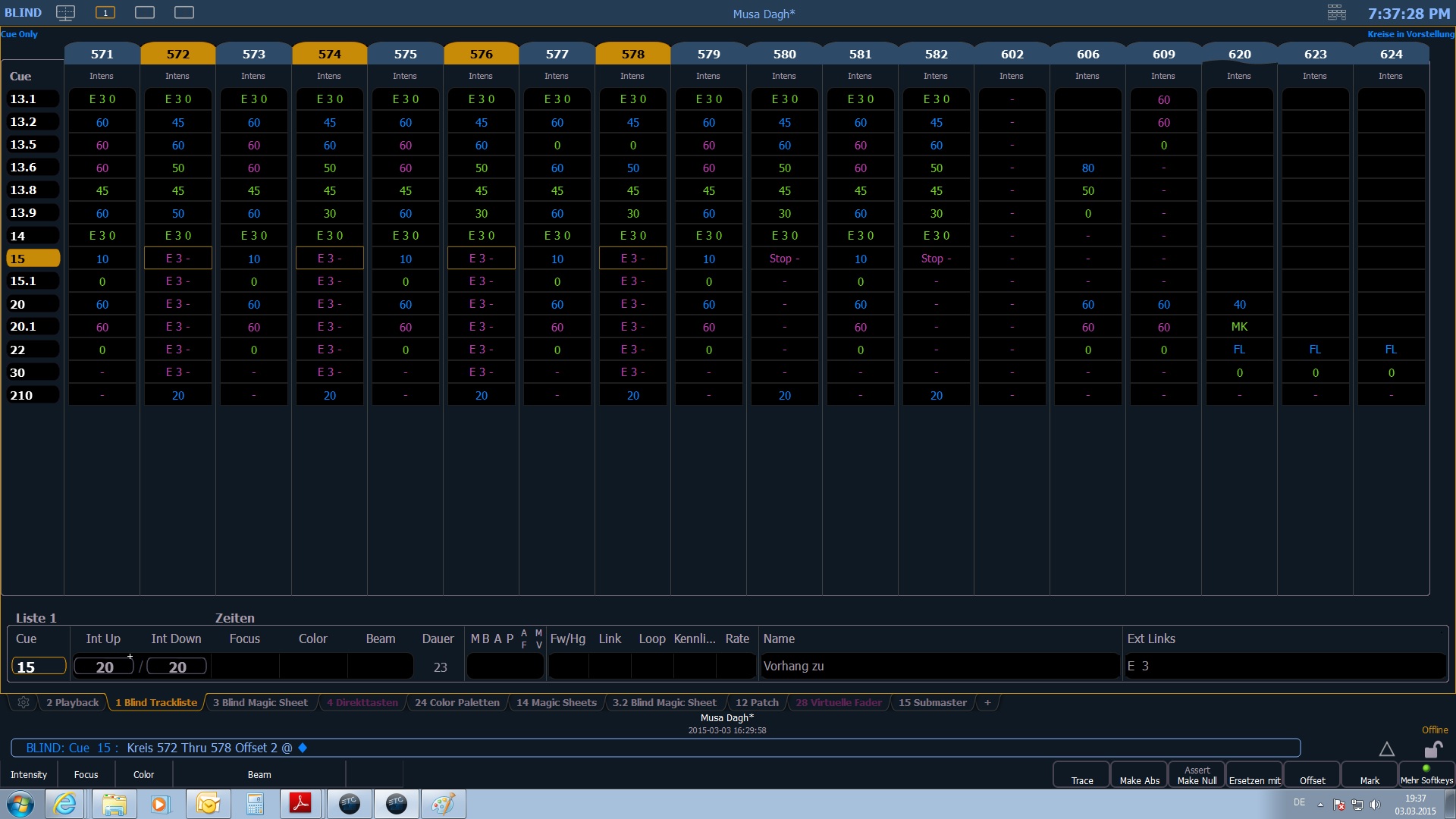

Had a problem with the autoblock-cleanup funktion. I´m working Q-only.

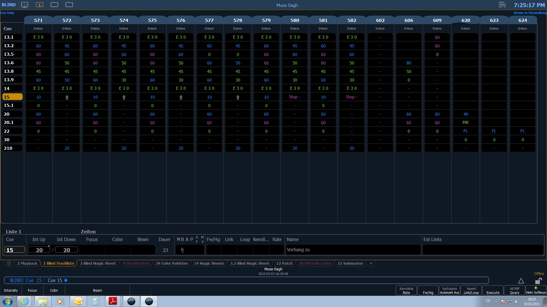

Had an effect on two 6-Bars in Q14 - level without effect 0; in Q15 the effect went out and level stayed 0. The zero-level was auto-blocked in cue 15.
When I used autoclock-cleanup: "Cue_1_/_AutoblkClean" the console tracked the effect till the next cue those 6-Bars got a level above zero again.
Before I learned about the cleanup softbutton I did that manually. I selected all cues in blind block everything and unblock everything after that.
That way everything works fine. No tracking - I just get rid of the white zeros.
I´d think autoblock-cleanup shold work the same way. So am I right and this is a bug or do I miss something?
