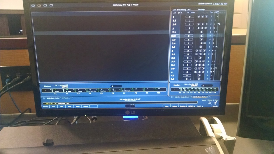

I am experiencing a problem on my Ion consoles with the 2.3.1 update.   The Playback Status Display opens up blank sometimes (none of the columns are visible, although the highlight bar corresponding to the active cue is visible). I am experiencing this on all three of my Ion consoles (2 older XP based units and a newer Win 7 unit). This may be related to another problem I am having with PSDs opened in very small frames. Sometimes when I go to adjust column widths in these small PSDs the column closes (disappears). If I keep clicking on the remaining columns they close also. It happens somewhat randomly, but I can repeat the problem by opening several small PSDs and adjusting the column widths. Sometimes they behave normal, other times they don’t. I use these very small PSDs to view a few cues forward and backward in my show.
Here is the display after recalling a snapshot.  The PSD on the right was added as a backup for when this happens.
