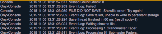

As of lately, the save function is failing on my Nomad Mac installation. I can save files fine using the Save As function (even into the ShowFile directory itself), however the save function or a save initiated by a master console on the network results in an error message stating that it failed to save to persistent storage.
I have tried deleting the ShowArchive directory, and have checked directory permissions (drwxr-xr-x) with no luck.
