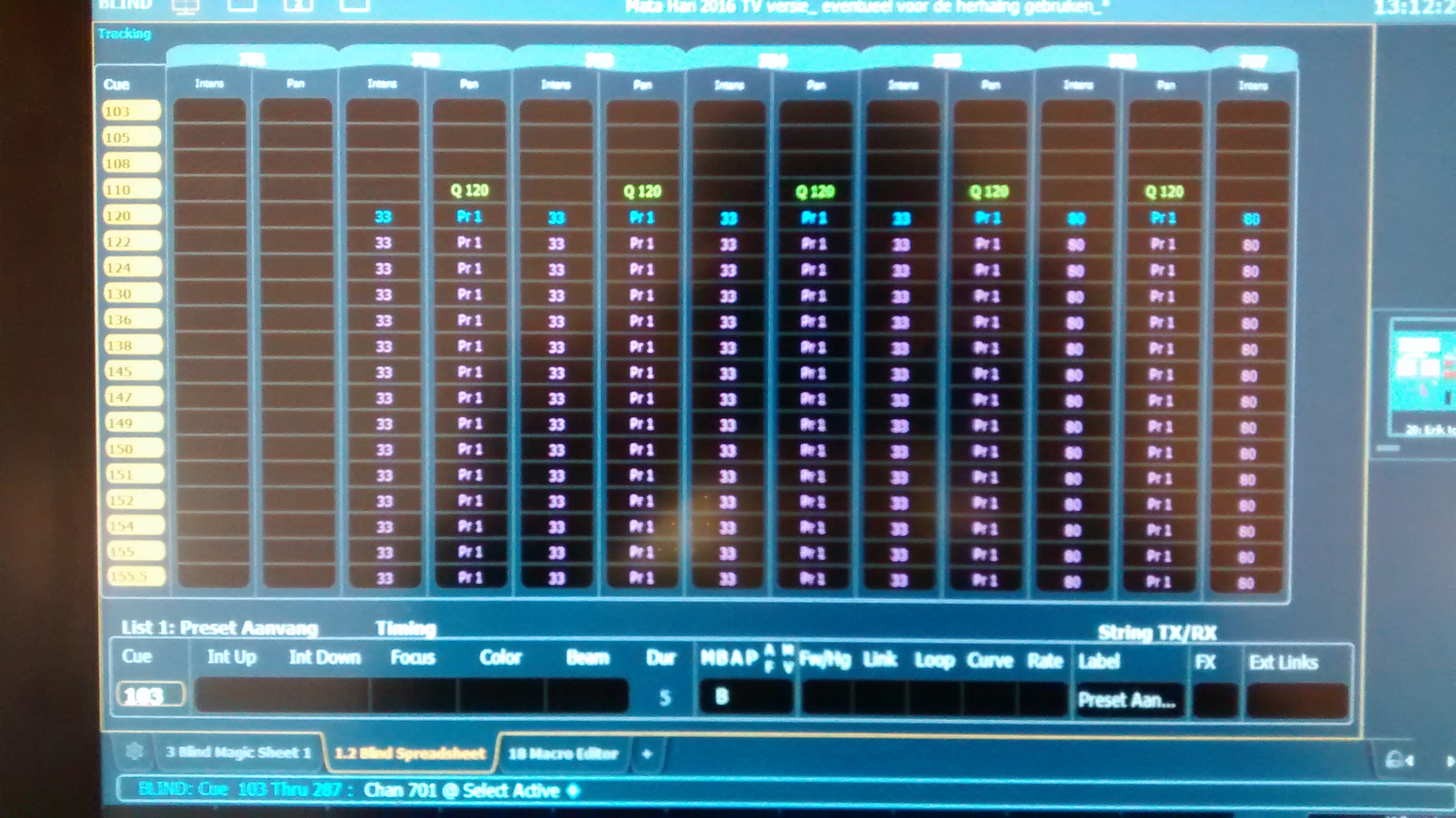

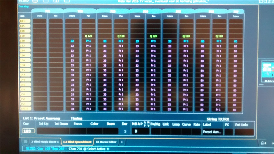

I was working in blind and using/trying out the syntax [cue] 0.1 [next] [thru] [enter], {channel} [at] [select active] and when I bumped the intensity wheel by accident after select active, it deleted not only the selected channels data but also a lot of other data from other channels from the cues.
The reason for trying this syntax is editing levels through the whole cue range without changing the points where the channel is at 0. By using +% or -%, +20 [enter] or /120 for proportional editing.
This is the data before using the syntax.

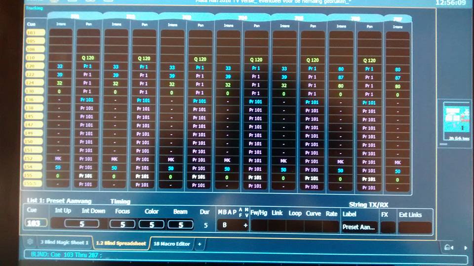

The data after the syntax. As you can see a lot more data has been changed.
