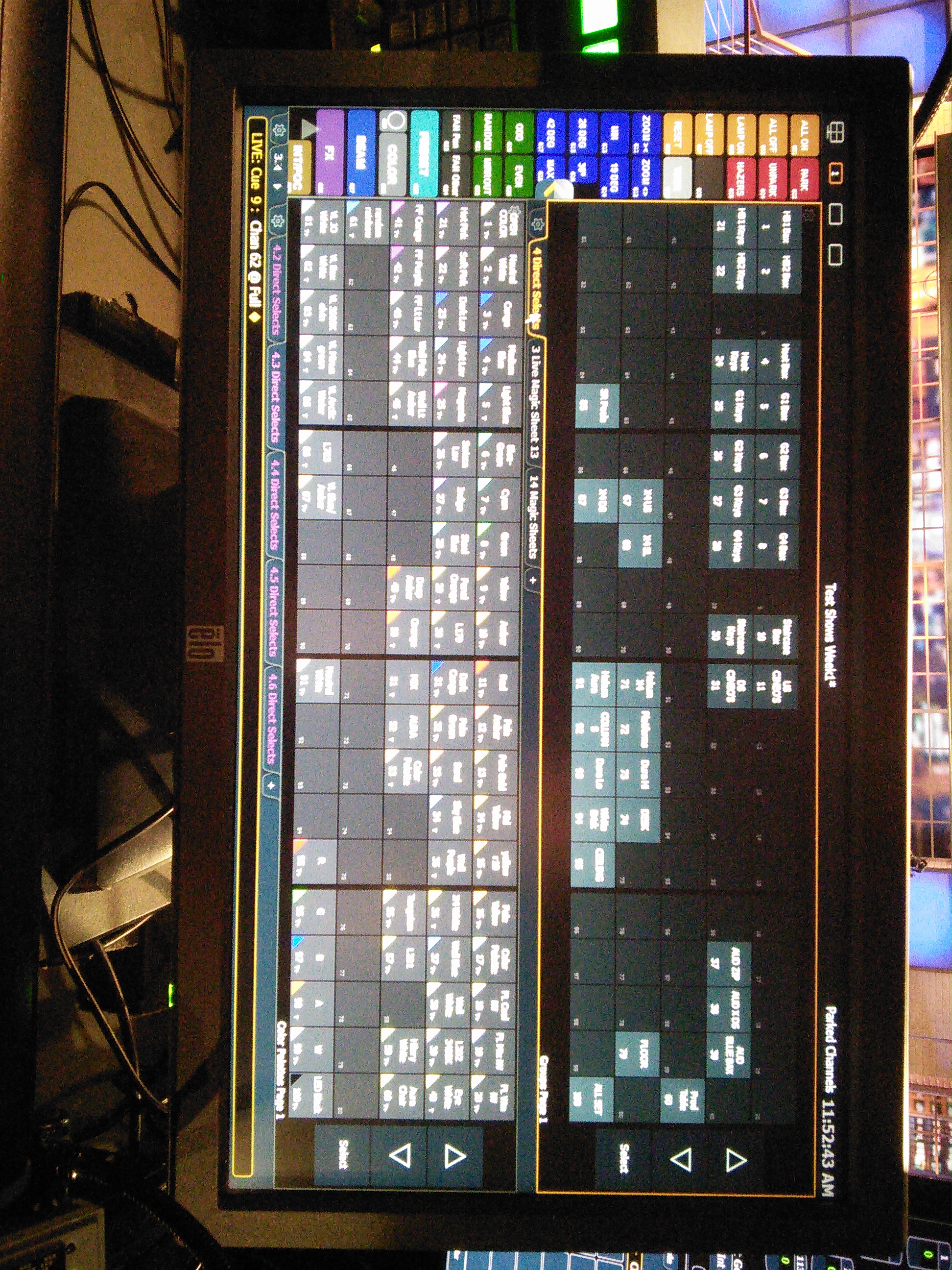

  • It's been a couple years, but I have used the software on an 11" Macbook Air.  It had the same vert. resolution as that touch screen.  Generally, it worked fine.  The CIA made things a bit cramped, so I would recommend using this touch screen as your secondary display, not your primary display.  However, that display only has a VGA input, so I think you're stuck with it as your primary display.
    For *years* I ran the client software on my 13" Macbook Air (900px tall), and that was totally fine.  The software is pretty resilient, but obviously there are no guarantees that it won't break with some future software update.  Your mileage may vary.
  • For the record, I purchased the 1919L, which is larger, but the same native wide-screen resolution,  1366x768. It works great on my console.
