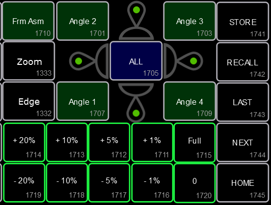

  • Another "head scratcher" I'm trying to build a series of buttons that allow me to manipulate my diffusion in my spot fixtures. I've made two that are simple BP buttons (Frost 100%/Frost 0%) that do what they say. I made two more that are to add/subtract a percentage of the frost.
    Using a PB's macro of "select last_param_@ + (or -) 01 enter" I figured this would work as it has on many other attributes but it doesn't. These fixtures require that I hit Shift then manipulate the encoder wheel associated with the frost in order to bring it in or out. It also requires this in order to speed up/slow down the rotation of my prism effect.
    Oddly, the prism (beam/fx) does not have an associated speed attribute button (beam/fx speed) which is present with other fixtures in my rig.
    So, the question, is there a way to incorporate the shift button (which I could neither find in the macro editor nor could it be hit while in learn) and manipulate a given encoder wheel?
    Macros I've tried...select last_diffusion_encoder 2 @ + 01 enter (did not work.) Select_last_diffusion @ +01 enter (did not work.)
