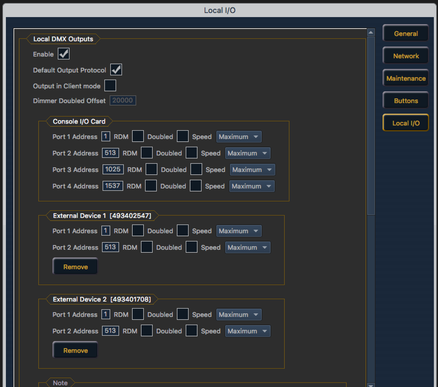

  • OK, so funny thing, I got it to work last night, went to bed, got up and now it doesn't work again. (I think me getting it to work was just an accident). I know my patch is working because it did yesterday...
    1) The most recent. I updated yesterday to troubleshoot. (So 2.6?)
    2) Mac OS 10.11.6
    Here's a photo, and the 1st External device listed matches my gadget's serial number.
    Thank you!
