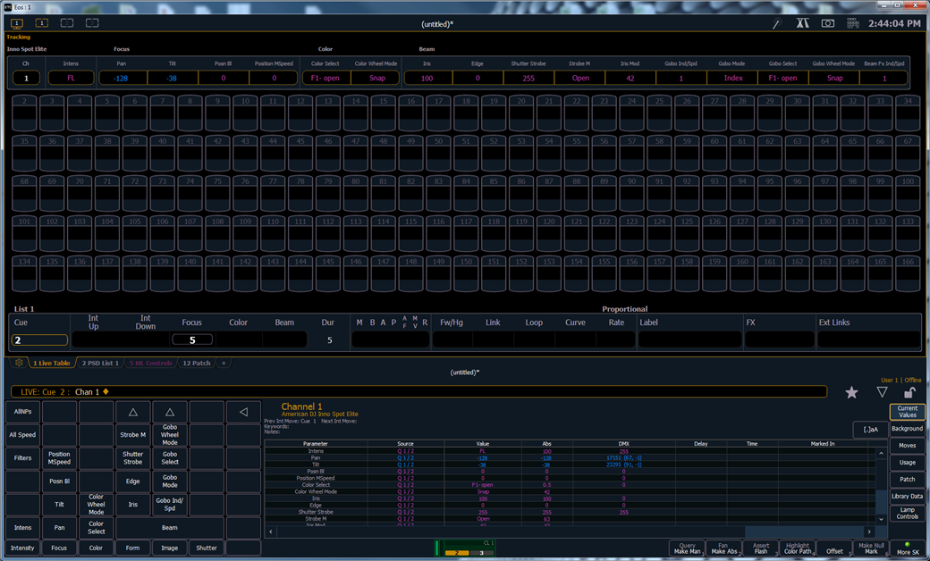

Hey, so I have two Inno Spot Elites and when they move the light goes out until they are done moving. How can I fix this? Thanks1
It would be helpful for troubleshooting if you can run the cues with "About" open and the channel selected.
Select the "Current Values" button to see what the console is sending to the light. That way you can figure out if it is the console somehow fading the light out or if it is the fixture doing it internally.
I have not used these lights, so I'm just going off the information in the manual and EOS profile.
