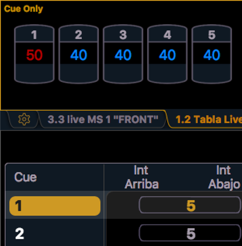

There are difference between captured channels, in the old expression system, you can set for example ch1 to 50%, you can move subs (containing this channel) and always the ch1 is 50%. Also for cue containing the same channel 1.
So, Captured channels (or channels in red) always have the high priority and only BLK OUT, GrandMaster or Parked channels can change this.
Im very confused because, (in eos family) if I have my channel 1 at 50% and I set a sub (channel 1 @ FF)  the sub have priority to the captured channel once the sub is at least 50%.

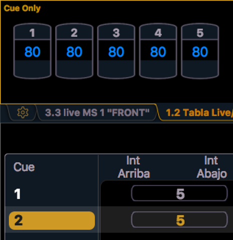

Also if I have loaded a cue, and one channel captured, if I press GO, the captured channel goes to the value of the cue 2. Whats the hell? I need my channels captured in red like in the express/expression desks.
