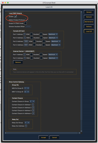

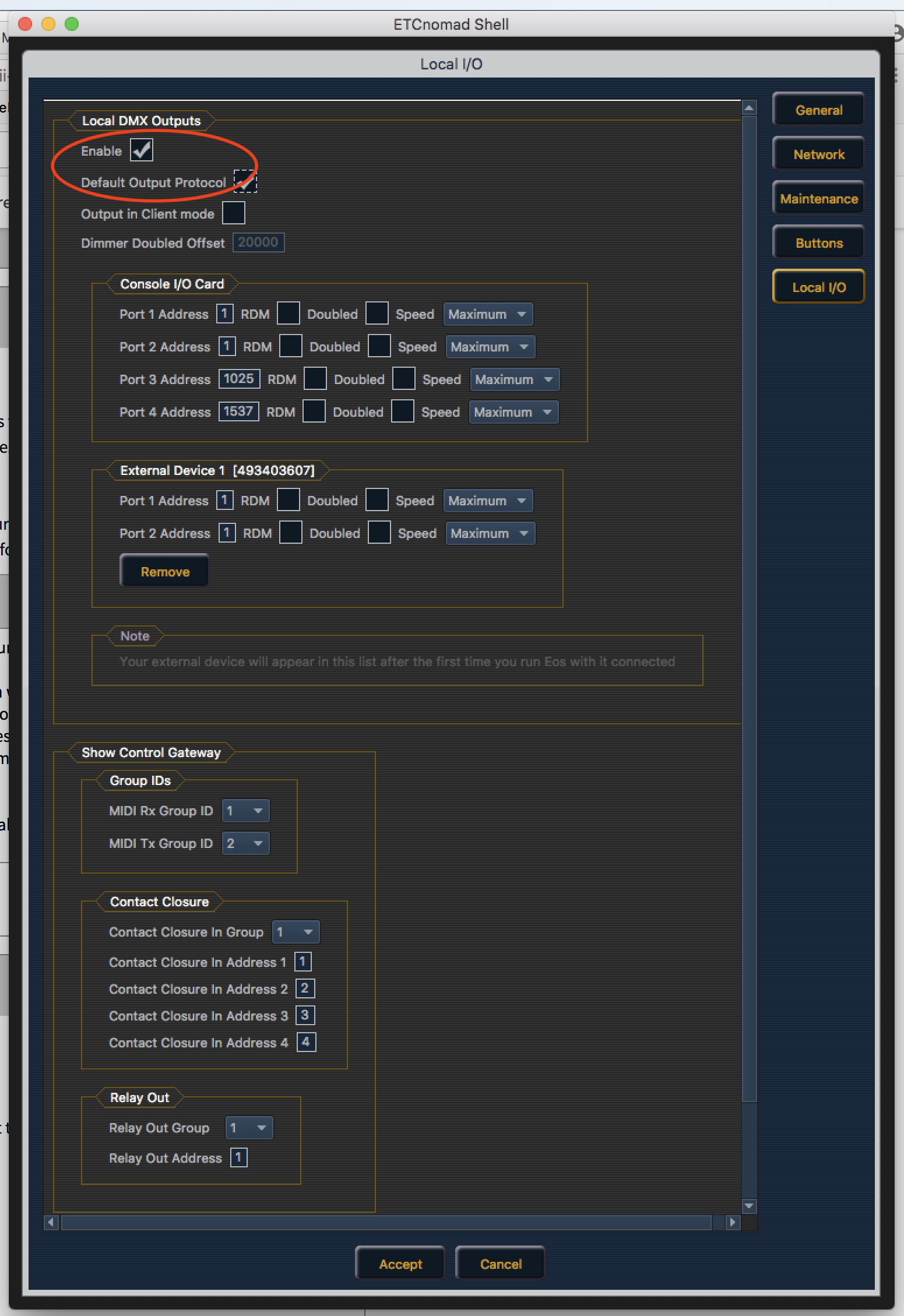

  • To update folks, ETC tech support is stellar, they call back on questions (which is likely why the forums don't have a ton of information on some things):
    I had the Gadget II showing up in the I/O section of the Nomad software, and it shows up when I run System Report (via the apple in the upper left hand of any Mac) as a USB Console I/O HS (the dongle is Sentinal HL). We also had confirmed connection inside of a Primary show. Holding Tab and pressing 99 brings up diagnostics, which showed connecting/disconnecting when plugging and unplugging the Gadget II.
    The end fix was under the Eos Family Welcome Screen - Settings - Local I/O. We need both "Enable" and "Default Output Protocol" checked. This enables the DMX output by default in the Patch settings, which was our easy fix. Something that should normally be defaulted (but might not be re-set during a reload of the software, which we did), but which leaves the patch without DMX by default.
    So, easy fix! One check mark! Thanks for the phone assistance ETC!
