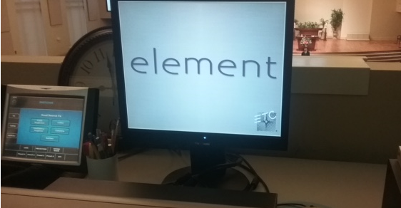

Currently the Element console stucked booting logo. It did not go through any show file.
The monitor just showing ELEMENT logo.  Anyone knows how to reboot or factory reset? I did hard power recycle but no luck.
