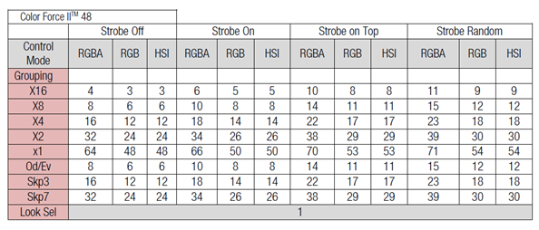

Q1.  I am requesting a Fixture library
* Chrnma-Q’s ColorForce II 48 (1,2,4,8,16 Cell) model
The ColorForce II 72 has a library(by cell) but there are no ColorForce II 48 model
I need a permanent library.
Showline’s SL BAR has libraries for all cell modes.
I tried to use copy to ColorForce II 72 , but I can not modify the library
It can not be edited by copying to the desired cell mode.

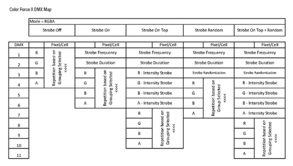

I attached the required DMX chart.
We hope this equipment will be permanently added to the next library.
CQ_ColorForceII_UserManual_1_1a (2).pdf  < - manual

    For Question #1: We have the ColorForce II 48 in the fixture library with Multicell Modes. This will require you being updated to the latest fixture library patch version for v2.7.0 in order to access.

    You say you have a library, but I can not find it.
    I have installed version 2.7. ColorforceII 72 is included, but not ColorforceII 48.
    We hope to be able to control cells by groups of 1, 2, 4, 8, 16.
    colorforceII 72 has a cell library, but no all grouping.
    I need a fixture-like library below.
