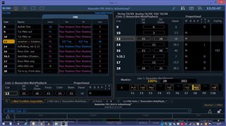

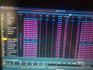

    I took pictures of the PSD and the tracklist at the desk which is on 2.6.4 and it looks like this:
    I have a live-move in Q12 and in Q14 but there is no L shown...
    Today I opened the showfile in Nomad 2.7.0 and get this:
    Here I get at least one L in Q14 but shoudn´t there be one in Q12 as well?

  • L = Livemove in Eos indicates a channel fading it's intensity from or to 0 % while moving a non-intensity parameter at the same time, not a channel moving while the intensity is already on. In your example, Channel 708 is already at Full in Cue 12 and therefor doesn't produce a "L" in the PSD. The term "Livemove" can be misleading in this context..
    An example for having a L flag is a Channel fading out while changing it's colour in the same Cue. (And that's why Query Livemove is such a good tool for cleaning up, as is Query Darkmove.)

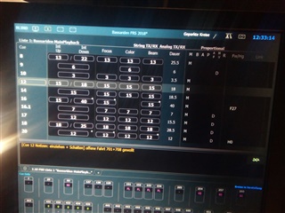

    Regarding your Automark question, is it possible to see the PSD and Blind Speadsheet of the Channel in question ?
