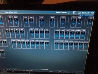

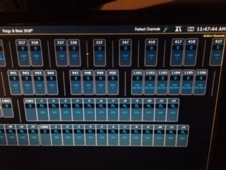

Has anyone else been getting small pluses where no small pluses should be?  I first noticed it on Lustrs in RGB Strfan +7 mode. A + was showing beside the Colour Palette label, despite everything being in there.  I checked them about a million time both in blind Colour Palette and Live to make sure I had all the parameters in there and I did.  But still I was getting OW+.  Then I saw that it was happening on some of my Lustrs, but not all.  They're all patched identically and ByTyped in the CP.  I was then that I noticed the really fun bit. Sometimes the pluses were showing in Live but not in Blind or viceversa. I've attached a couple of pictures showing this.  You can see that it's the exact same show, the exact same time and that everything is completely blue, but if you look at c1101 - 1106 there's no + in Live but a + in Blind.  It's completely inconsistent as to whether it shows or not.

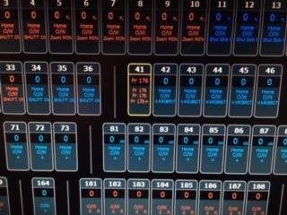

I've started getting it on the Beam attribute for VL3500 Washes too.  Once again, I spent eras trying to find an attribute that had somehow gotten away from me or been filtered out, but no joy.  I finally accepted it wasn't me being stupid when I recorded a Preset with no attribute filter macro, just 41 Record Preset 176, and it had a plus without me touching anything or recording it or anything.  I've attached a third photo showing that.
