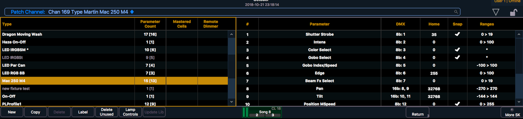

  • Well if you want to figure out what is going on then in patch click Show at the bottom left to see the fixtures in the show and click edit and then hightlight the MAC250 and on the right you get what the profile looks like.
    You'll see something like the screen shot below, you can see 16bit pan and tilt and if you cloik on the dot in ranges you will see how parameters that have ranges can be set.
  • Now that is friggin awesome! Couldn't find "Show" but [Display] {Patch} {Features} bought it up. Your notes and picture pasted to my bench notes with great thanks.
  • Kind of cute calling it "16bit" I thought. Makes sense. I'm OK on bits, bytes MSB/LSB etc so now off to the fixture editor to see what's happening. Great thing about EOS is you can mess around on your own computer without having to sit at the console. I'm communicating with (Student) Capture, so controlling the MPDs can be a visual experience.
