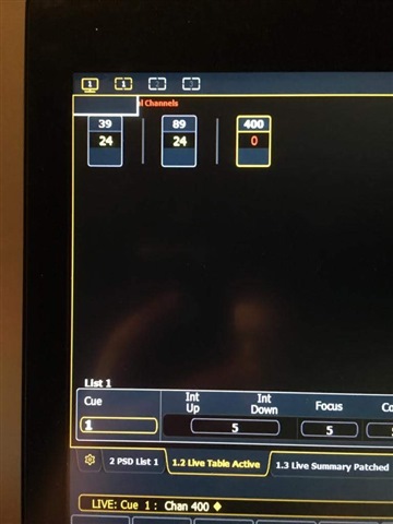

does someone have the same issue after updating to 2.8 running on gio@5
no problems with the desk but strange look; the square in the live table disappears after mouse over.

That is most likely from the manual (tab 100). We saw this with 2.7, but off the top of my head I don't remember if it was in release or during the development cycle. It only happened when the console was restarted and tab 100 was open.
What version did you update from?
Does this happen every time you start your console?
Can you try rebooting the console, then stopping in the shell before EOS launch. General Settings, Monitor Arrangement, Apply the settings (which forces a refresh of the configuration), then Close, Close, Launch
thx try that on monday, don't know the version before because the desk is new in our house. was the first update ever.
