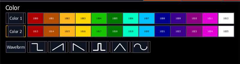

I am working on a busking setup where I can make custom color effects on the fly. As part of this I want a graphical display that shows the two colors and the waveform the effect is using. For example for a red and yellow ramp effect, the bars on either side of color 1 & 2 would be red and yellow.
Prototype Magic Sheet
The only way I know how to achieve this is to have the 'bars' be a separate object behind the actual button with its fill linked to the color of a dummy channel-which I just have a generic LED patched but with no DMX addresses assigned to it- then the color buttons to the side activate a macro that copies a color palette into a dummy palette referenced in the effects. I have gotten all of this working, but where I am stuck is how to protect the data in the dummy channel from being erased by Sneak. I have already accounted for recording the dummy channels into cues by putting all the dummy channels I plan to use in an excluded submaster. Although it wouldn't mess up the effect after sneaking, the color data is erased, taking the UI with it, and I would have no idea what colors the effect would run in the next time I use it.

  • Could the background object for Color 1 and Color 2 reference the "dummy" Color Palette that is referenced by the effect.    That would tell you what color the Effect is going to use.

  • I think this is the simplest answer.  My busking sheet has a set of standard colour pallete buttons.
    I then have two set colour buttons that simple do " Copy_To ColorPallete 100" and " Copy_To ColorPallete 101"
    I have two colour pallete buttons near my effects on the magic sheets that are Color Pallet 100 and 101
    The effects refernce CP 100 and 101 (and background) as appropriate.
    Then in use just click the colour swatch with nothing selected and click the "set colour" button and the swatch changes colour and then I select my channels and run the effect.
    If you do it this way then you dont need dummy channels and dont have to fight the channel ownership on them (I think you could fix that if you really need to by putting the dummy channel in cuelist assign it to a sub and play the sub - then it remains owned by the sub when you do other stuff)

  • Thanks! I did not know you could reference the color of things other than channels in magic sheets since in the editor it specifically says "link to channel color", maybe that should be changed to "link to target color" ¯\_(ツ)_/¯
    I'm glad there is a much simpler solution. I set the objects to reference the color palette and got rid of the references to the dummy channels and it works perfectly.
