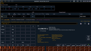

im private messageing you now i sent you a pic of my software version
Seems you are in software 2.8 which is good. Btw, easier and better access to software version is if you press about on a clear command line. In the cia you see every info.
Can you please post a picture of the about info?

Check in said about screen:
a software version 2.8 minimum.
B how many addresses of how many addresses patched.

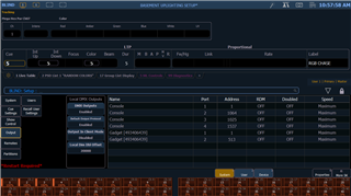

C try setup system output. You should see your gadget there. Check that output a is set to correct universe (output address 1-512) and port B to universe 2 (output Adresse 513-1024).

Go to the shell, network. Scroll down to Allowed Output Addresses and remove the two ranges there.
great that worked thx for all your help
