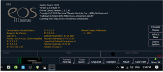

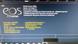

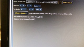

just installed EOS v2.9.0 on my pc (offline testing before upgrade of the ION) and there is no fixture library. I can install a library in the shell, however it does not show in about or patch!
any suggestions?
photos attached
Thanks a lot!

On macOS 2.9.1beta I can't see this problem.
PC/NOMAD *Windows 10
Have tried to install as administrator, still not working. Running Windows 10 Enterprise 64bit
Odd -- the fixture library should be installed to a commonly readable location for all users, regardless of admin installation (%PROGRAMDATA%\ETC\Eos) -- it may be time to contact phone support and start troubleshooting with them directly for a speedier resolution to the problem.
