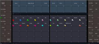

As a learning experience, I'm trying to build a replica of the menu-ing system David Kane shows in his videos.  I wish to make the lower-middle frame change with whatever options are chose by various Direct Selects around the system.

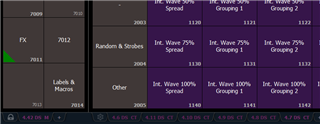

On the "original" machine, the snapshots are recalled and only tab 4.6 opens.   On every other machine, it shows the correct snapshots, but it opens a new tab with increasing numbers (4.7, 4.8, etc) instead.   I've replicated this twice now.   I made sure when I recorded the original snapshot, it was always recorded in tab 4.6.
