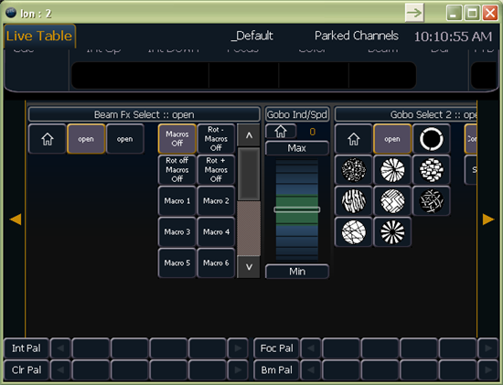

I noticed that there doesn't seem to be a way to control the prism on a martin roboscan 918 with my ion. Is there a way I can add that control parameter under the "custom" page of encoders? I am using the "roboscan pro 918 M2 GS" personality.

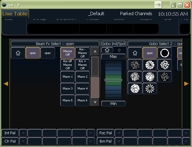

I have 4 roboscan 918s in my rig and have had no problems controlling the prism. It's in the beam parameters, or on the image encoders. The ML control shows them as Rot +/-/off Macros Off.
Edited to add. The virtual encoders appear to load strangely in 1.8.0. I'm not at the theatre so I can't verify the real encoders behave properly and load the prism controls on encoder 4, as I remember them doing.
