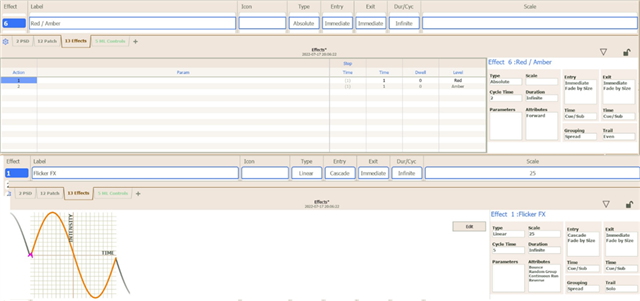

We are doing Sweeney Todd and I want to produce a red-hot flickering "Oven" when the door is opened.
I have produced a pseudo "Bonfire" with a simple RGB LED lamp in the past.
Two CPs were created, one Red and oner Amber. Then, two special FX were made: One was 'Absolute' to swap the CPs. The other FX was 'linear' to affect a flicker.
To use, the ML is put so INT = Full and then FX 1 and 2 applied. It works pretty well but I get the impression its either ALL CP 1 and then CP 2 (IE Red OR amber). I would like to see some mixing of red and amber. That is for them to fade into one another at times. How would I go about this or does anyone have a better way to produce an oven fire with a simple RGB ML? Thank You
