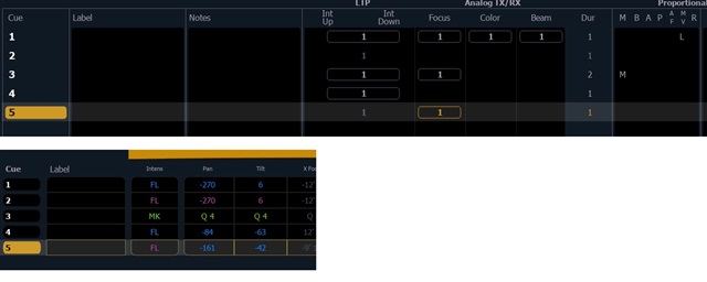

I am getting myself confused (easily done). trying to get comfortable with the PSD Flags I set up a very simple show file.
Two MLs are lit in cue 1 stay for cue 2. ML 107 is turned off in cue 3 and the beam moved in cue 4. As expected, we get a "M" in the first flag column.  However, in cue 5 with the ML still lit we move the beam again. I was expecting the 6th (m/v) column to show me a "L" (move when lit) at cue 5. But the "L" is appearing for cue 1! (Again, with no change between 1 and 2). This seems odd to me. What am I missing?
