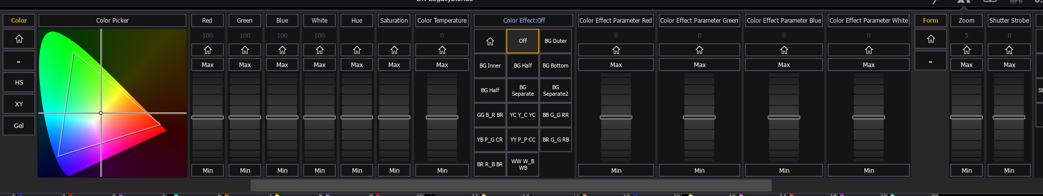

I've got a light that has multiple sets of RGBW for effects.  It has the normal RGBW, but then also Colour Effect Red/Green/Blue/White.
Is there a way to have two colour pickers, one for the main RGBW and the other for the Colour Effect RGBW?
The light in question is a UKing ZQ02356 7x40W Bee Eye Mover.  I created my own fixture profile for it - So maybe I've set something wrong in the fixture profile?

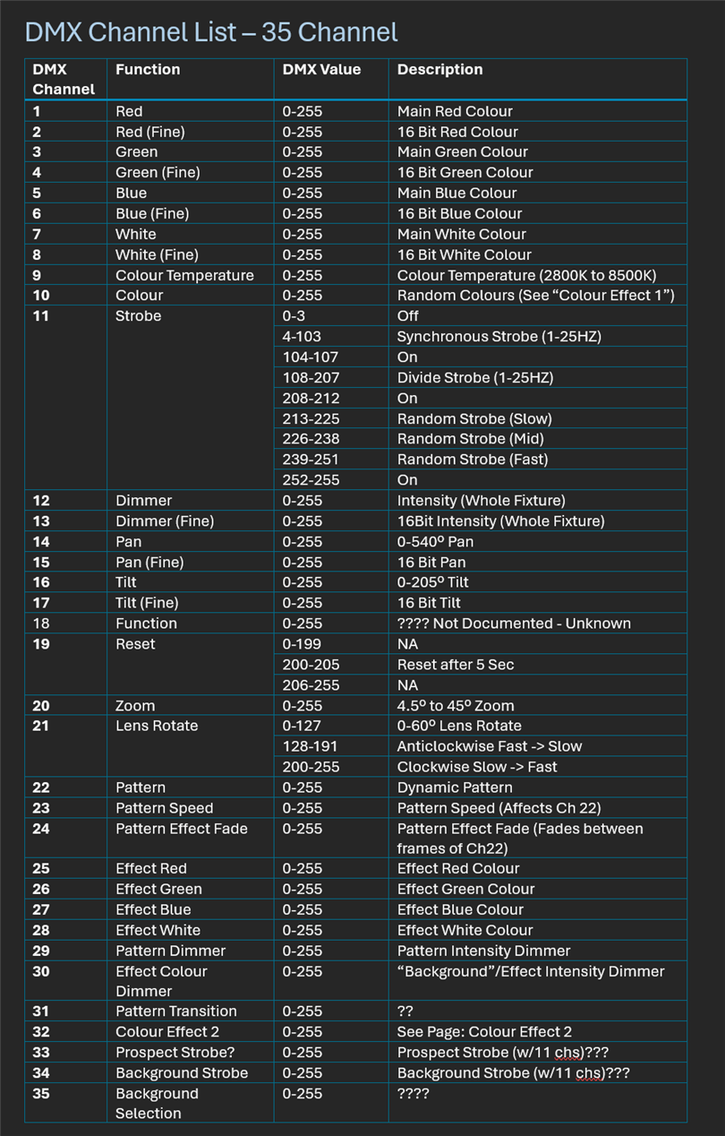

Here's the DMX Channel listing (Translated from the really bad manual included)
Main RGBW = Ch 1 thru 8 - Effect Colour RGBW Ch 25 thru 28
