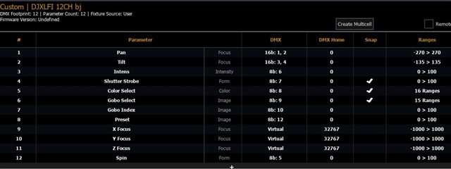

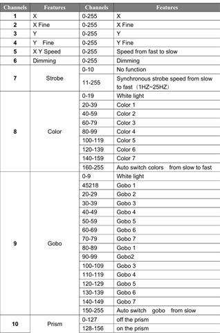

  • Just to understand the problem a bit more... When you try to control these cheap MLs from the ML Controls Screen (not the light hack) they do work, but for some reason when trying to control from the Lighthack box initially they are non responsive.
    My initial thought would be that it might be that the light hack is sending a value (more granular) to those fixtures which is causing a problem with them, but when you use the more course control of ML Controls, then they avoid those problematic DMX values? Are the 8 or 16-bit pan/tilt fixtures. I wonder if it is something like that. What is the actual fixture and what fixture profile are you using on the console?
  • "150W MOVING HEAD Mini BEAM SPOT LED" is all the booklet reports.
    I think you are right. Some other things I have noticed are a definite inertia when the pan control is used on the Lighthack: IE When I turn the encoder, the ML moves in a granular fashion (as though the fine pan isn't working). And, when I stop turning the pan continues! Very weird. You point it to a spot and then it continues moving for a short time!
    As my Lighthack seems to do a good job with a variety of other MLs we operate, I'm not sure how to deal with issue.
    Fortunately for this show I'm using some effects on four of them and they are behaving.
  • A few things to try:
    1) Try using a 8-bit pan/tilt profile on the fixture and EOS (if possible)
    2) Try swapping the fine channel (pan 2, 1) and tilt (4, 3) -- I've seen these messed up in cheap fixtures before.
    3) Make sure you're using pan/tilt with those fixtures instead of XY or XYZ...
