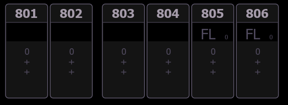

I can't figure out why these two channels (805 and 806) are showing FL and a small 0 next to them. The about fixture details does not show a source of these values.  They are showing up in Live, but not in blind when going through the cues if this helps the detective work.  I am working on Nomad 3.2.2 Build 36 on Windows.

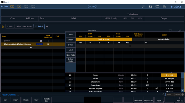

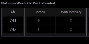

    The value of 100 is the User Value, programed in the Fixture
    The 0 in the Main window is just the DMX Value-Home.
    The wording of intensity it not the best, in my eyes. because the manual says that dmx 36 is the Color-Preset-Dimmer. A crossfade or Color-Macro-Intensity is more fitting.
    actually this should not do anything for your int on stage.
    Better rewrite the fixture. because if you like to edit it on the fly, you will never realy do anything, because the main int do not listen to something like [5] [at] [35] [Enter].
    This might only do something if you use the Color macros.
    what a fixture. The Elation way is something i never understood.
