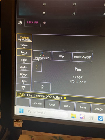

  • tu record xyz values in a cue, pst or else, yu just need to select the source and clic on format pan tilt in the encoder display. then command line indicate ch f format x y z activate , and x y z will become red and will be the recorded values (and pan tilt will be grey). i get 2 macros, to switch quicly from pan/tilt to x y z.
Reply
