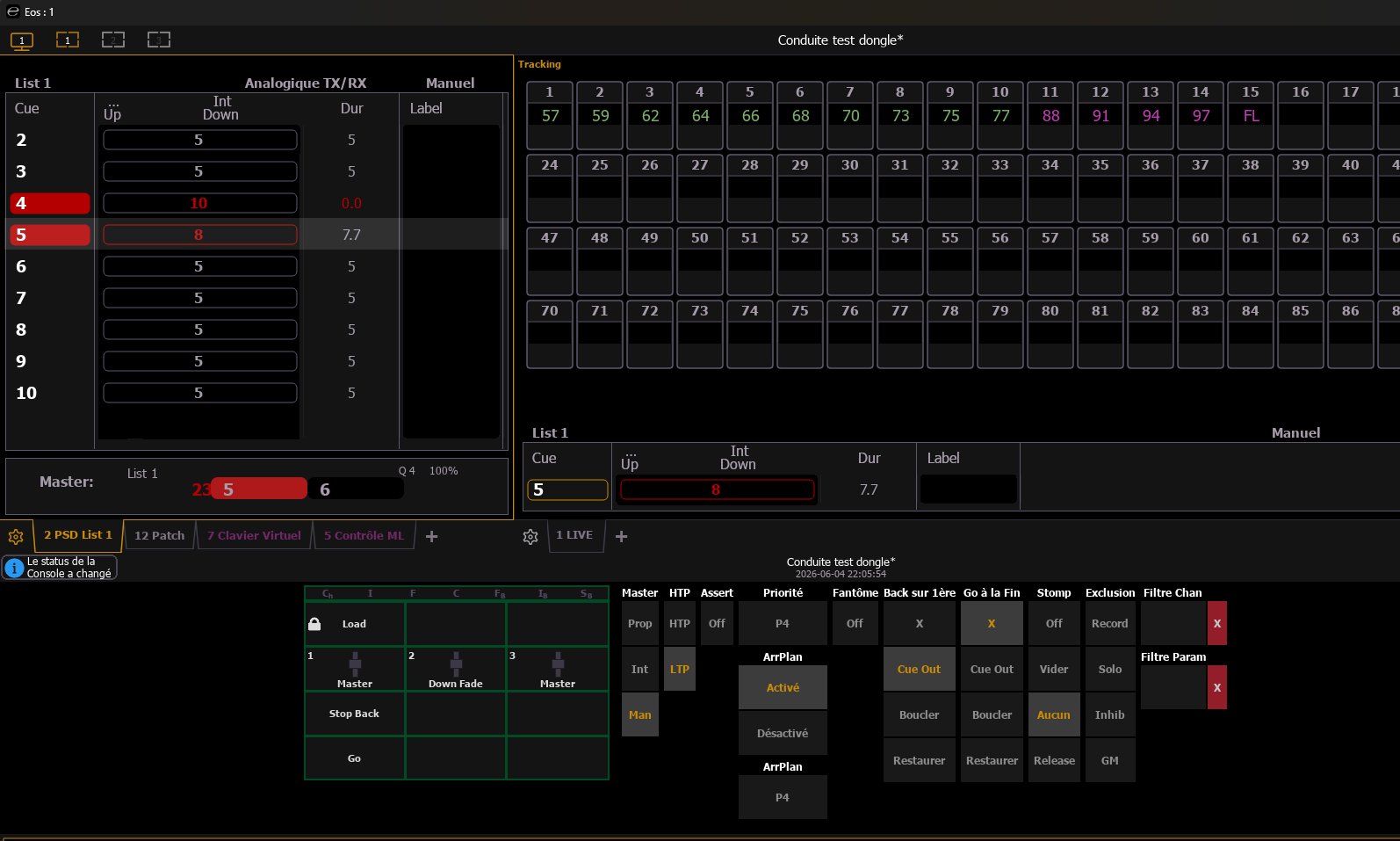

Hi,
if you set master of cuelist manual and fire a cue with intensities down the last cue appears in red in PSD.
Hi,
This is currently written up as
[EOS-58413]
After firing a cue with split time, with channels using down time, the previous cue will turn red until the fired cue completes.
Same problem here. Using a GIO updated to 3.3.8, and when manual master is applied with the main fader pair, no downfade happens, only up moves to higher values.
Same issue here!
This was fixed in 3.3.9.
