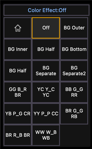

5. When a fixture has special macro modes where there may be as many as 70 or so different effects on a channel - do you just leave the channel as a 0-255 sort of channel and just label it an effect macro channel, or would you set it up with buttons for each effect?
Example here - it's different combination of the foreground and background colour - then modes with set colours (it's a 9xLED Bee Eye style light, so GG B_R BR would be Top Row: Green Green; Middle Row Blue, Blank, Red; Bottom Row: Blue, Red).

    5. I guess that's an example of having to find a balance between time spent vs comfort when using the profile. You can still control the fixture without the ranges but you'd need a list to somehow know the DMX values. But if you know you're not going to use this parameter anyway, then there's no harm in just leaving it as 0-255.
