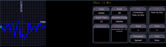

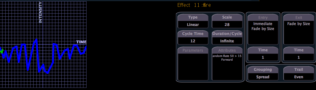

    My most successful fire effect used the relative effect type.  I drew my flame pattern on the graph, so my flame could undulate and flare as well as flicker.  Even though it repeated, it looked pretty random, and I randomized the effect rate somewhat.  The relative effect has the added benefit of affecting the live intensity, so you can control the absolute brightness of the flame.
    -Josh
  • Josh,
    Fire effect idea looks great and will try that.  I could do the link cues but I miss the Obsession simplicty of creating quick and decent lightning effects.
