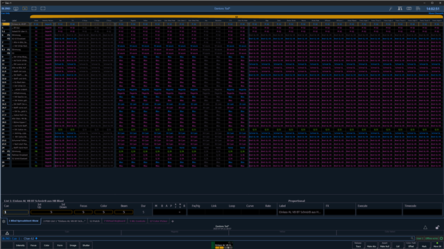

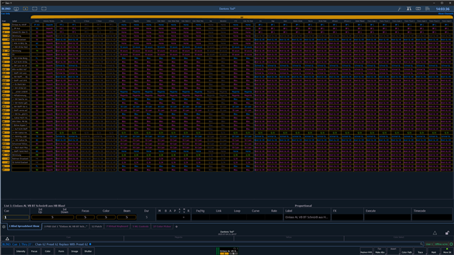

Your post got me thinking about how you could be able to unnest palettes from presets in bulk. I was able to get this to work to a certain degree.
I grabbed a showfile that I knew was pretty tidy. In LIVE Cue 1, for Chan 62, I stored FPs, CPs, BPs and nested them inside Preset 62. Update Track #.
Now I changed Preset 62 to an Absolute Preset. BLIND: Cue Thru # Chan 62 Preset 62 Replace With Preset 62#
This effectively unnests Preset 62 and can be done in Bulk over a range of Cues and Channels for singular Presets. Maybe this can be macrotized to boil down to a "Unnest Preset" Macrobutton.
Hopefully, this is helpful.
This is a good work around.
