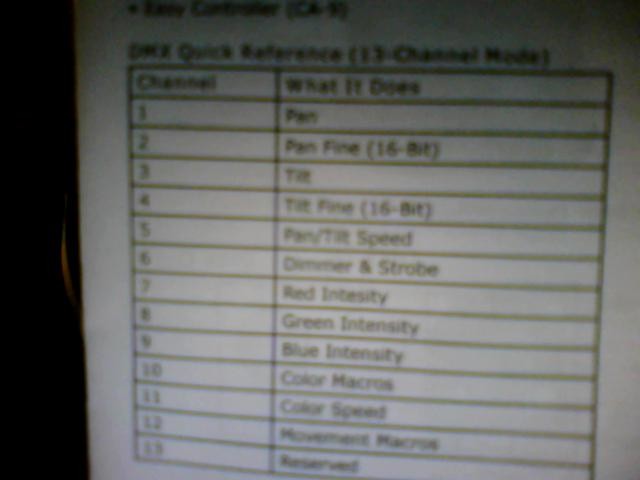

    I've been through that section of the manual, I'm comfortable with most of the basics, and am with you until you start mentioning the control parameters, which I haven't yet gotten into (beyond actually using them, anyway). I'll have a look at those and see if I can figure out how to modify them, if I can at all, once I'm back at the console.
    I have just downloaded the 1.9.8 beta offline software - woot! - and noticed that one of the fixtures I'd actually been asking about is now in there: the Blizzard Lighting Flurry Wash 13ch, which is actually a carbon version of the Chauvet MinWash 13ch profile, from what I can tell. The Eos' profile for the Flurry has an error, however - the channels for pan fine and tilt coarse are swapped. [I think the Chauvet has the same error, but am not 100% on that.] The electronic copy of the manual I've seen is consistent with the console's default personality - but the hardcopy that came with the light, and the behaviour of the fixture IRL puts the order as (ch1-4: Pan, Pan Fine, Tilt, Tilt Fine). I've mentioned this in an email to Anne already, so by now this may be just an FYI.

    The intensity for the fixture still doesn't work for me - either in the default profile, or the one I ended up using after modification attempts... So as a workaround, I've been setting the home values of these fixtures at full brightness and intensity, and colour values at zero. The downside of this is I then need to use one of the subs as a GM, inhibiting the colour values of these fixtures, and the intensities of everything else. :(
  • Hi Jonathan,
    which fixture do you have there? "Blizzard Lighting Flurry Wash 13ch" or "Chauvet Lighting Mini Wash 13CH" ?

    You attached a (blurry) copy of a DMX Chart. Was this for the MiniWash or the Flurry?

    And the DMX Chart for PAN TILT is the same. Is your hardcopy different?

  • My hardcopy's different - yes. The unit now ships with the Revision B manual. In your link, the quick reference on page 5 is correct, but you'll see the detailed DMX chart on page 14 still has a persistent error from the previous version. I've verified this is in error with the actual fixture - the proper sequence is Pan, Pan Fine, Tilt, Tilt Fine - just as with the Chauvet.
    The Chauvet and the Blizzard, from what I can tell, use the same base, the same logic, the same profile - or ought to, when the profile's fixed. The original Blizzard downloadable manual has them incorrectly placed.

  • The standard profile for Chauvet has Pan, Pane Fine, Tilt, Tilt Fine.
    So then the Standarf profile in the Ion is correct.
  • Yes, originally I'd modified the Chauvet's profile to match the manual's version of the Blizzard (with the error included). So it was my fault the 1.9.6 Chauvet profile was wrong for those channels - but the intensity settings for that fixture are still out of whack, from what I've seen.
  • You're absolutely right -- the intensity is acting strange indeed.  The profile is correct, but it appears that it's related to handling the inverted dimmer parameter and this fixture.  We're currently looking into the cause and the fix.  Stay tuned!
