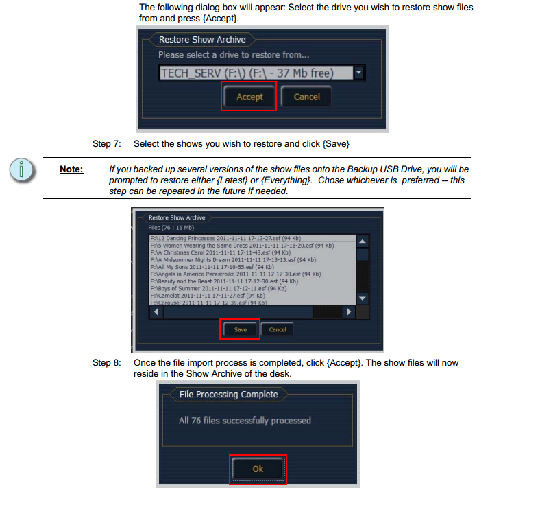

    Have you checked out the File Manager in the Shell? If you Exit Ion, under Maintenance  you will fine a button for File Manager which will let you do batch copies.
    In the same Tab, there is also "Backup Show Archive" and "Restore Show Archive" which may also work for you. I've never used the Backup/Restore so I'm not sure if you can only restore if you did a backup, or if it just searches the chosen directory for any .esf and takes it back to the hardrive ShowArchive directory.

    Yep, been a while since this string but been so busy and haven't had a chance to go over it until today.  Originally I just did the Restore Show Archive way.  Wow, yep the File Manager is great because you can do copy or move in either direction and pick and choose as well.  Thanks.  Anyone not familiar with this check it out.  After exiting the console you will find Maintenance in the Setting tab.
    Of course like anything else.  Make sure you are doing what you want.  Deleting, Moving, etc.
