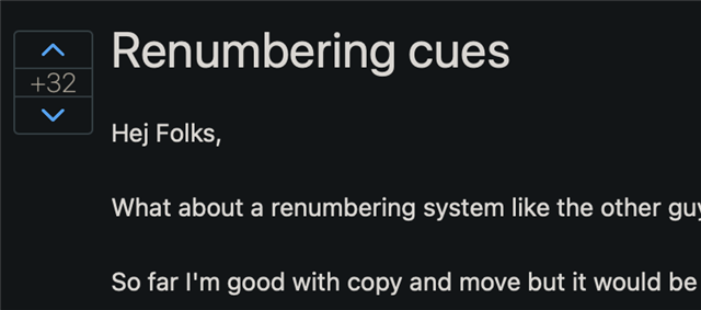

Renumbering cues
Hej Folks,
What about a renumbering system like the other guys have to do get cues in a numeric order just in one step?
So far I'm good with copy and move but it would be convenient sometimes.
The other guys do that with popups but I think syntax should work as well...
